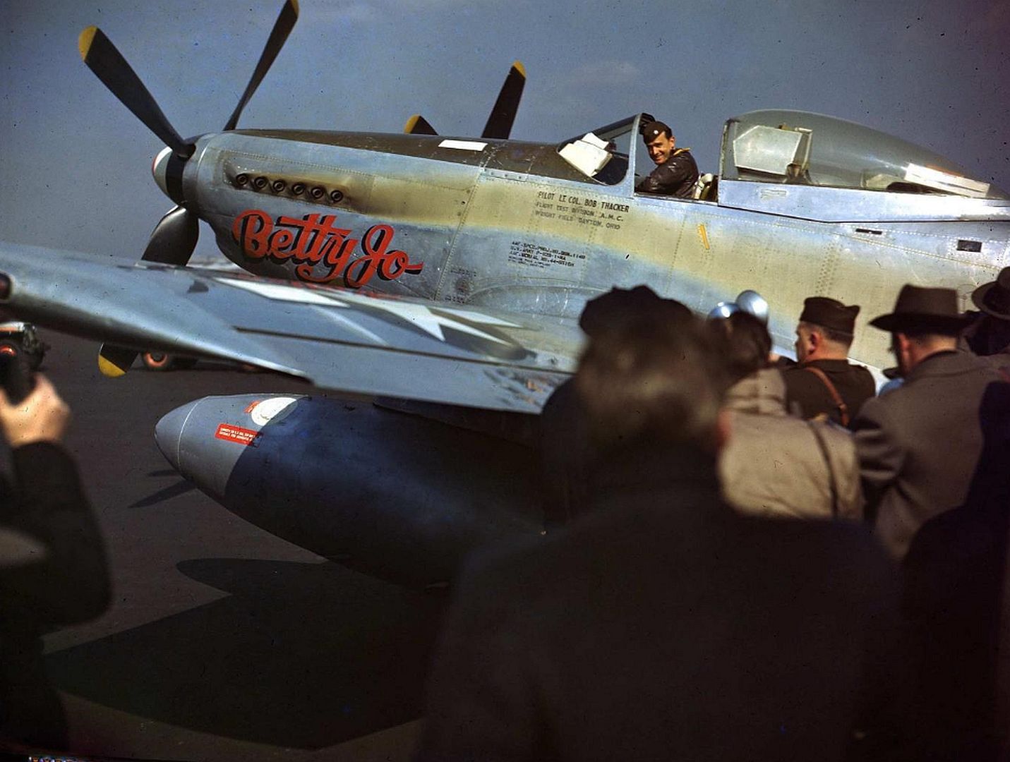

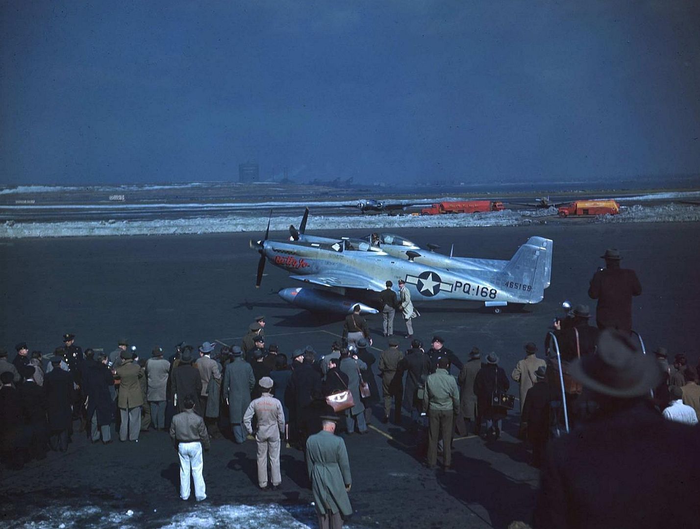

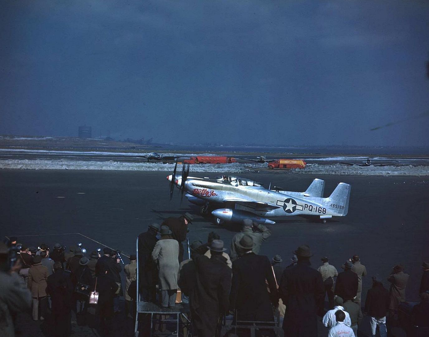

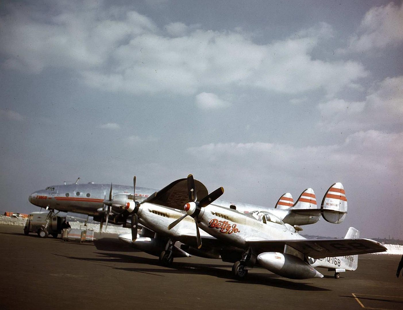

On 28 February 1947, a P-82B named BETTY JO, the ninth production item, piloted by Lieutenant Colonel Robert Thacker (Betty Jo was his wife) and Lieutenant John Ard, set a record for unrefueled flight in a piston fighter, flying from Hickam Field in Hawaii to La Guardia Airport in New York in about 14.5 hours. This aircraft had been stripped down, modified with additional internal fuel tanks, and fitted with four oversized 1,150 liter (310 US gallon) drop tanks. The total distance covered was 7,998 kilometers (4,968 miles) and the average speed was 559 KPH (347 MPH). That was faster than the top speed of most combat aircraft at the beginning of WW II.

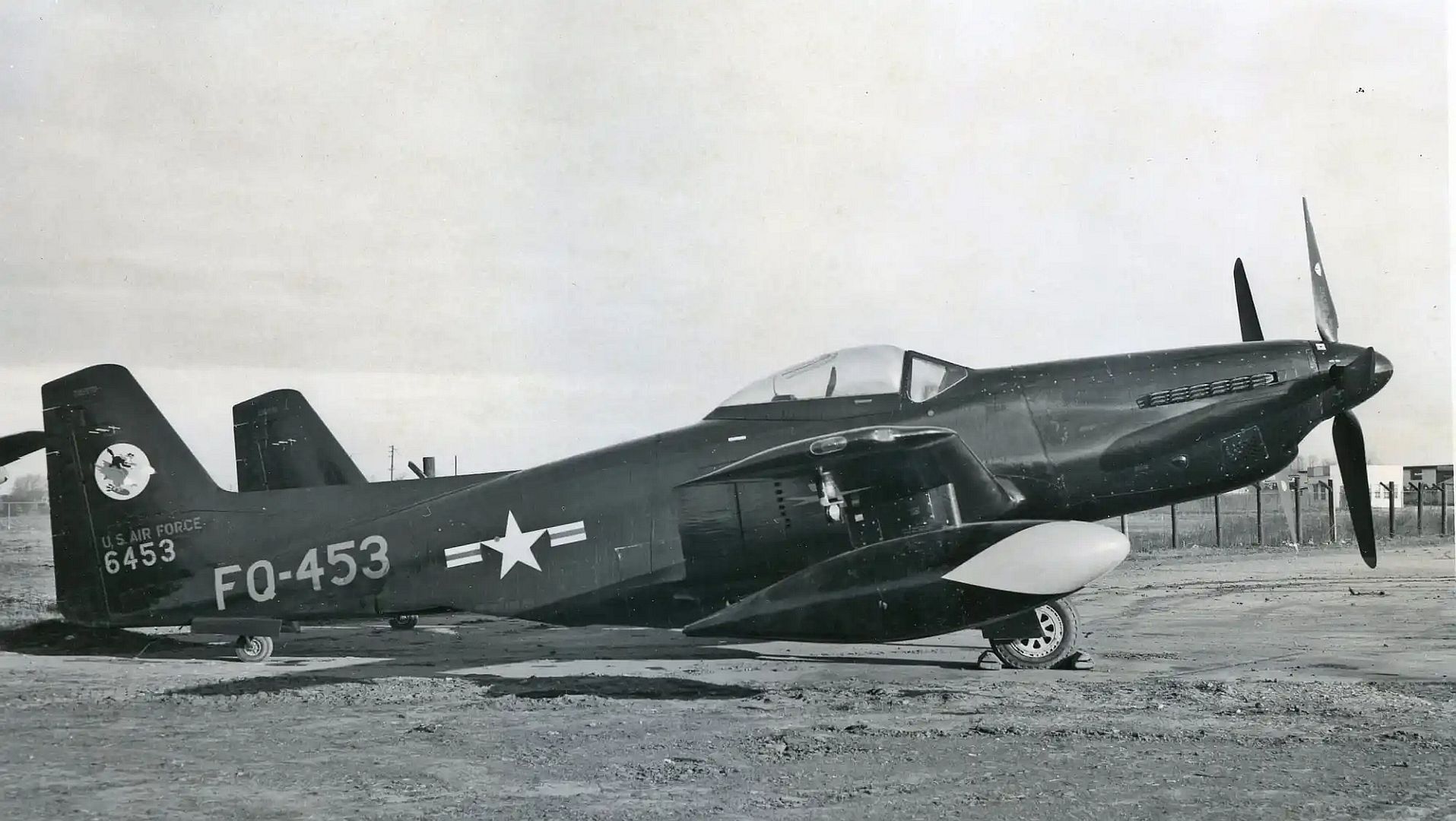

* The night-fighter versions of the Twin Mustang achieved a bit more distinction in service. In September 1946, the USAAF had ordered 100 "P-82Fs" with AN/APG-28 radar, an improved version of the AN/APS-4 radar used on the P-82D, and 50 "P-82Gs" with SCR-720C radar. These aircraft were Allison powered. Interesting, the big radar pod imposed little performance penalty. The F-82Fs and F-82Gs, as they would be known in service, also featured radar beacons, plus AN/APS-13 tail warning radar.
Before either type was delivered, the USAAF came up with a new requirement for an all-weather fighter for operations in Alaska. Nine F-82Fs were refitted with the SCR-720C radar, essentially turning them into F-82Gs, and both these aircraft and five F-82Gs were fitted with cold-weather gear, including improved heating systems. These were known as "F-82Hs", and were the last Mustangs ever produced by NAA.

AdminBetty Jo a couple years ago in the NMUSAF
