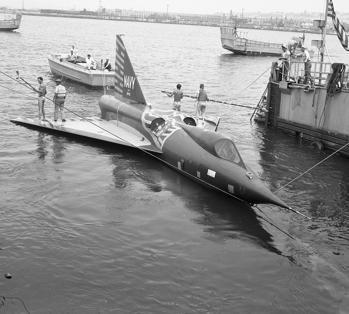

Main AdminThe Convair XF2Y SeaDart water-based fighter was the result of a design contest initiated by the US Navy in 1948 for a supersonic interceptor seaplane. The goal of the contest was to develop a high-performance supersonic naval fighter aircraft which could operate in forward areas without the need for land bases. At that time, the Navy assumed that it would be impossible to operate high-performance supersonic jet aircraft from the decks of aircraft carriers. For this reason, the Navy actually stuck with lower-performance straight-winged carrier-based jet aircraft such as the F9F Panther and the F2H Banshee long after land-based air forces had switched over to higher-performance swept-winged fighter aircraft.
Convair entered the seaplane fighter contest on October 1, 1948. Initially, Convair's proposal was for a delta-winged design with a blended hull which rested on the water and rose up onto a retractable step for takeoff and landing. Convair also tested a large number of seaplane designs equipped with hydro-ski configurations.
On January 19, 1951, Convair was awarded a contract for two prototypes of a water based fighter with a delta wing planform, a single delta-shaped tail, and a watertight hull. The aircraft was to take off and land on a pair of hydro-skis that retracted into wells in the side of the lower fuselage. The two prototypes were assigned the designation XF2Y-1 and were issued the BuAer serial numbers 137634 and 137635. The name SeaDart was assigned.

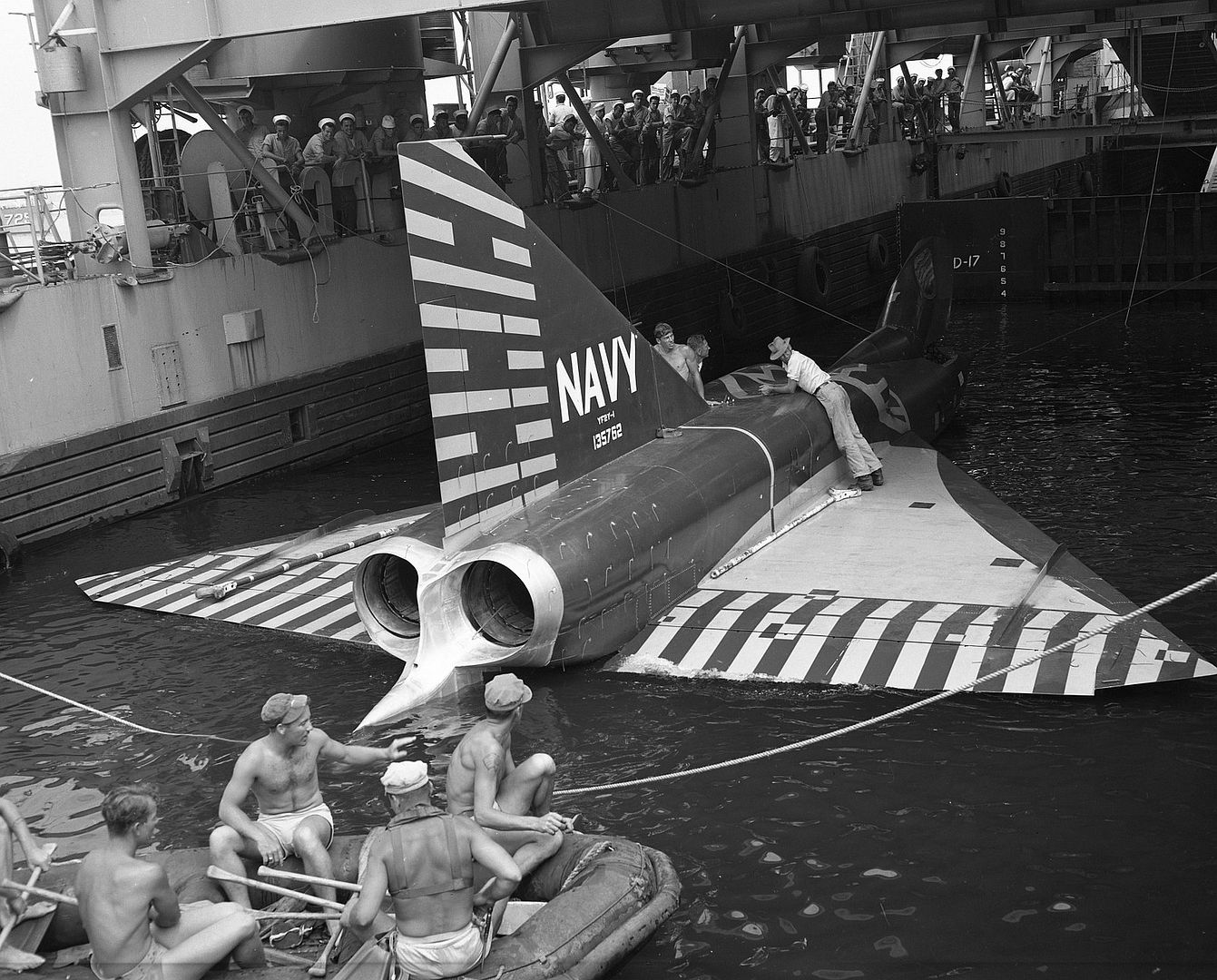

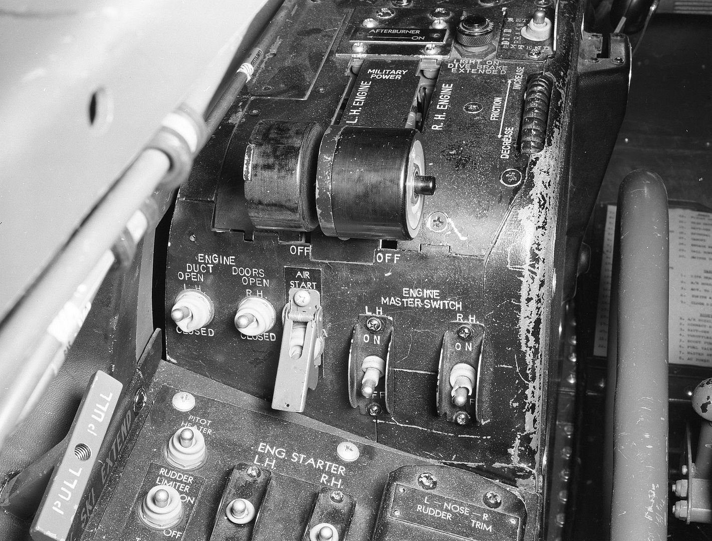

The SeaDart aircraft was to be powered by a pair of 6100 lb.s.t. afterburning Westinghouse XJ46-WE-02 engines. The engines were to be fed by a pair of lateral intakes mounted high up on the sides of the fuselage well above the wings and behind the cockpit, this location being chosen in order to prevent water spray from entering the air intakes during takeoff and landing. The hull of the SeaDart had multiple watertight compartments in the lower fuselage to prevent sinking in the event of a puncture. The lower fuselage of the SeaDart had the V-shaped profile of a boat, as would be expected for a water-based aircraft. Both the elevons and the rudder were hydraulically-powered. The aircraft was fitted with a set of dive brakes on the lower rear fuselage which also doubled as water brakes and as a water rudder while taxiing on the surface. When sitting at rest in the water, the SeaDart floated with the trailing edge of the wing and the elevons being flush with the water, and the leading edge of the delta wing at the juncture of the fuselage being about 18 inches above the water.

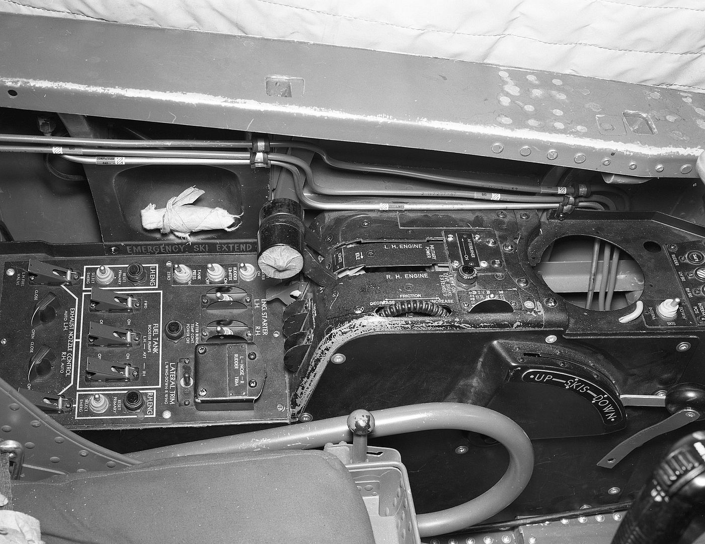

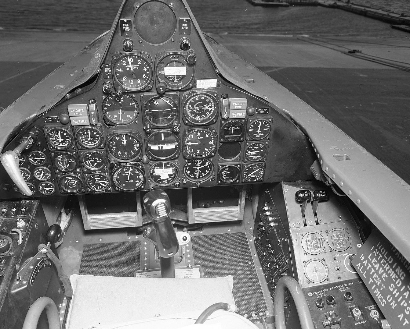

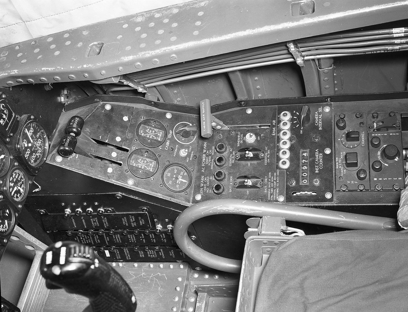

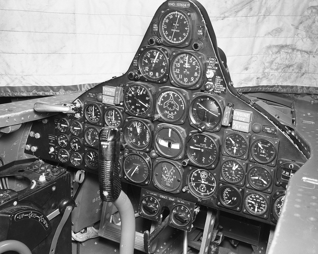

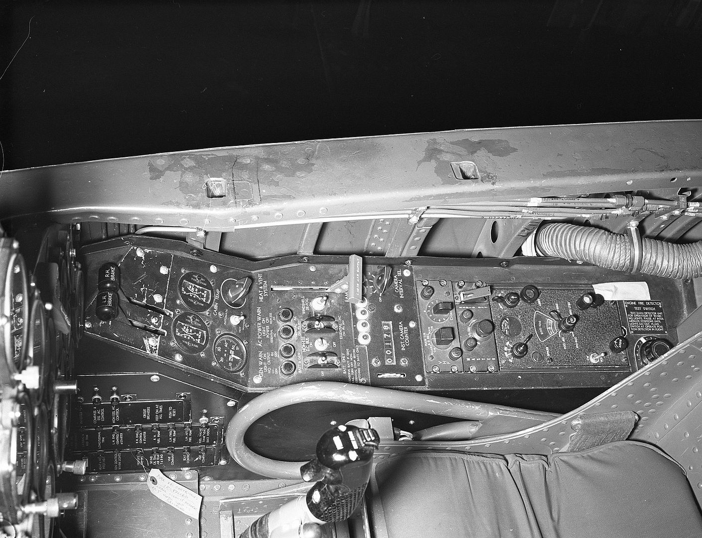

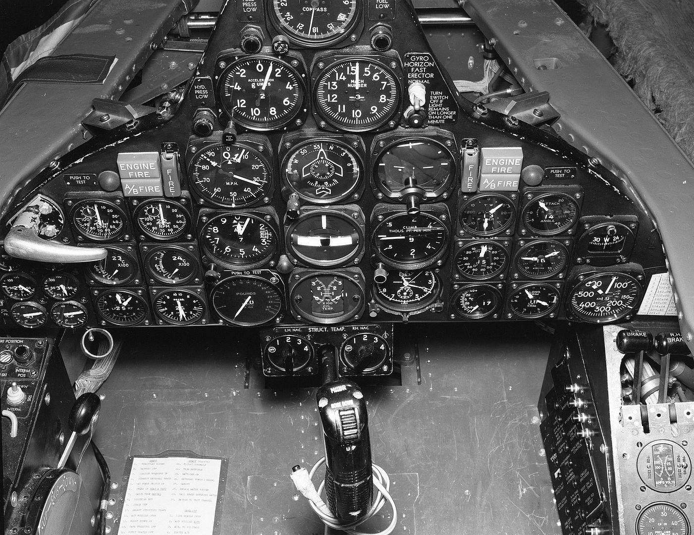

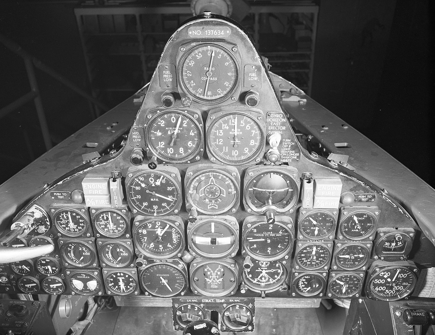

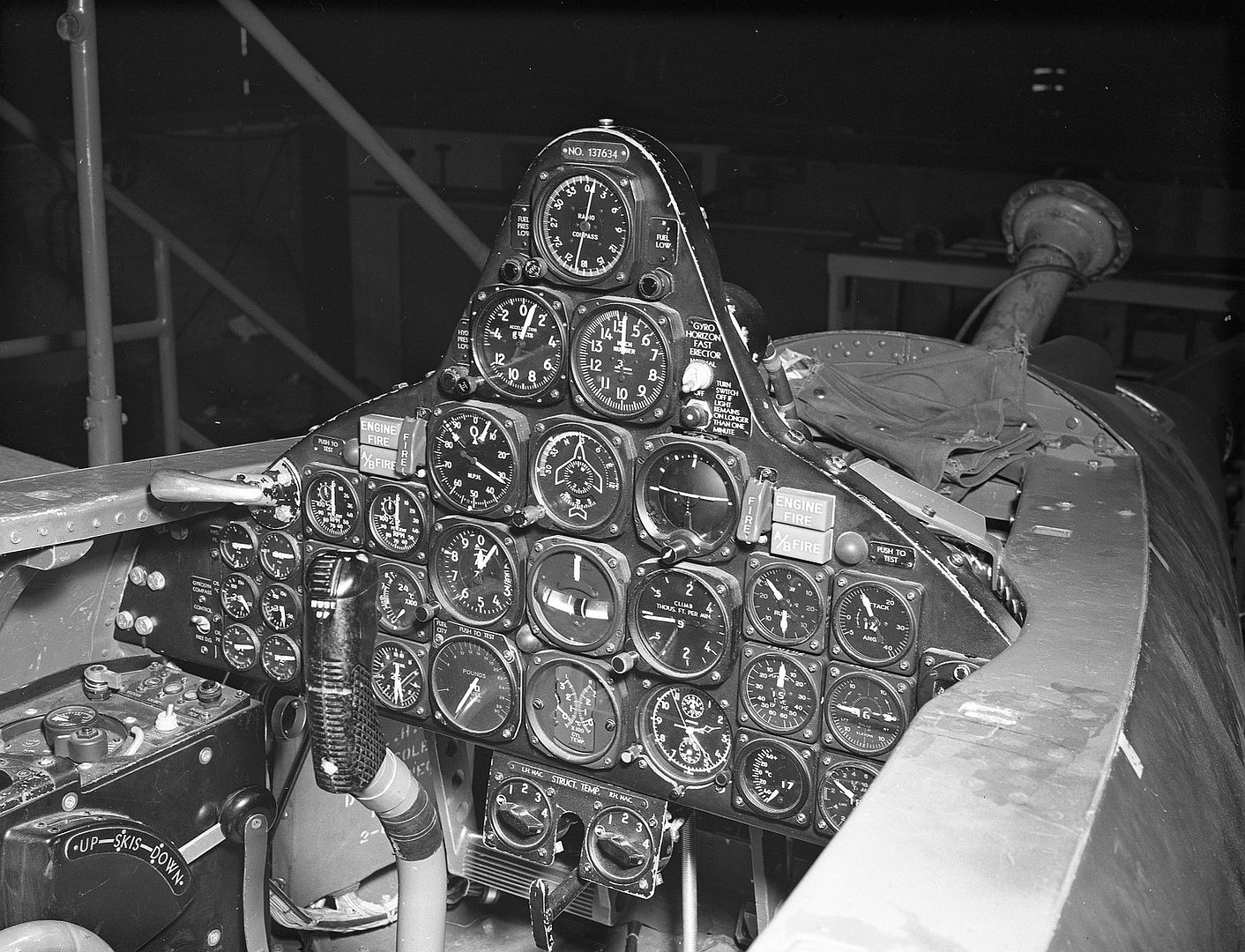

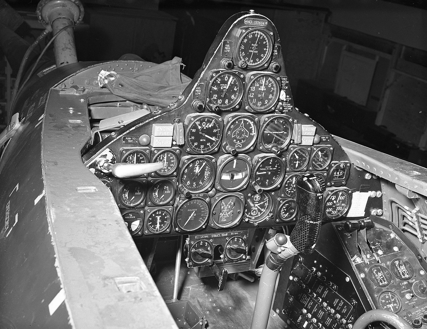

The one-piece cockpit canopy structure was hinged from behind the cockpit. When open, there was no windscreen in front of the pilot. The canopy was provided with two small transparencies on either side, separated from each other by a center post which obstructed the directly forward view. By all accounts, the view from the cockpit was rather poor, and would certainly have to had been substantially improved had the SeaDart ever entered service as a combat aircraft.

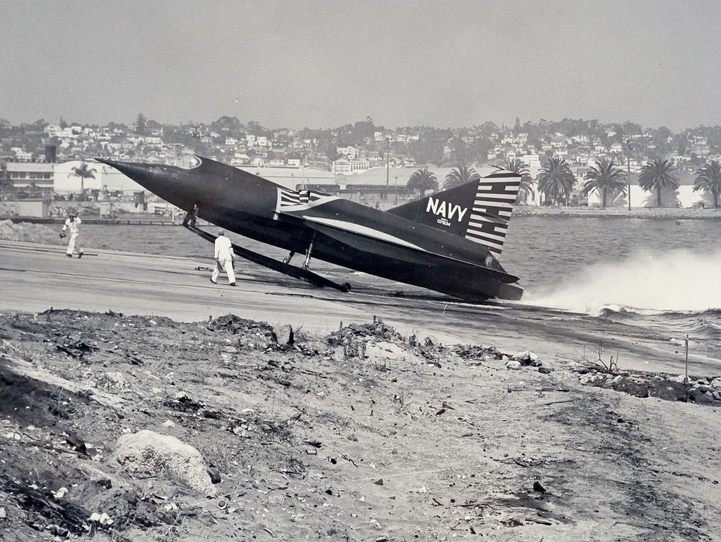

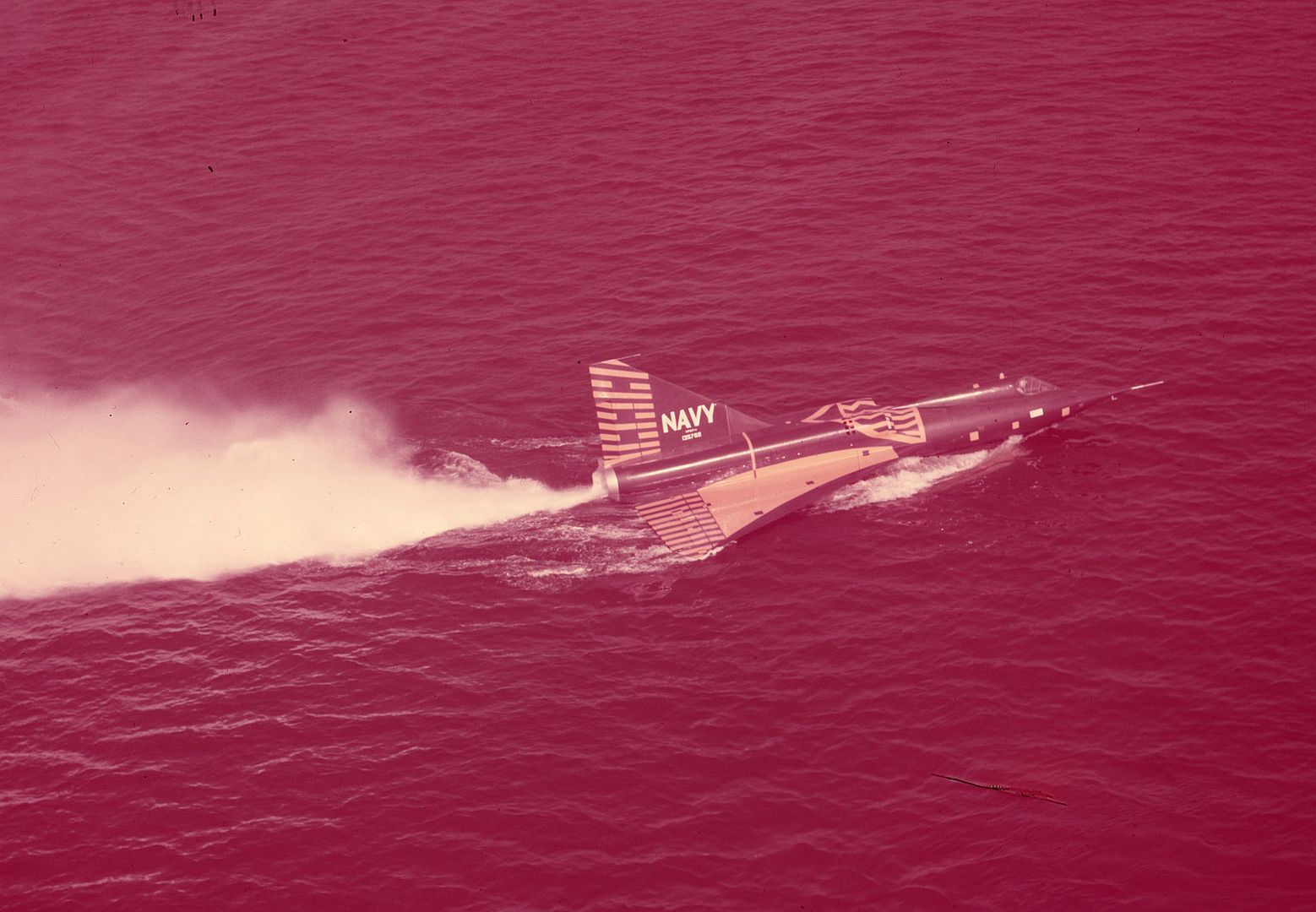

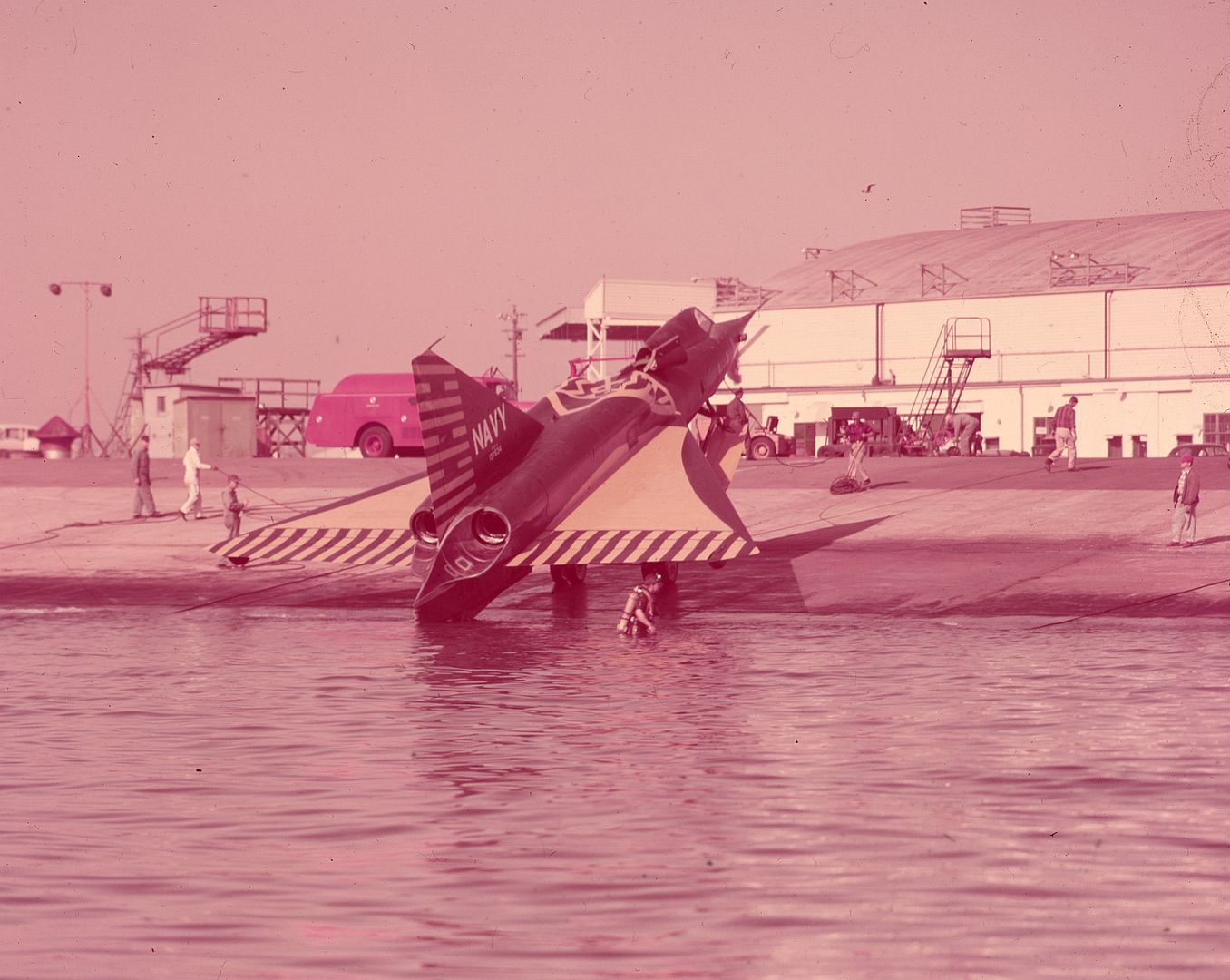

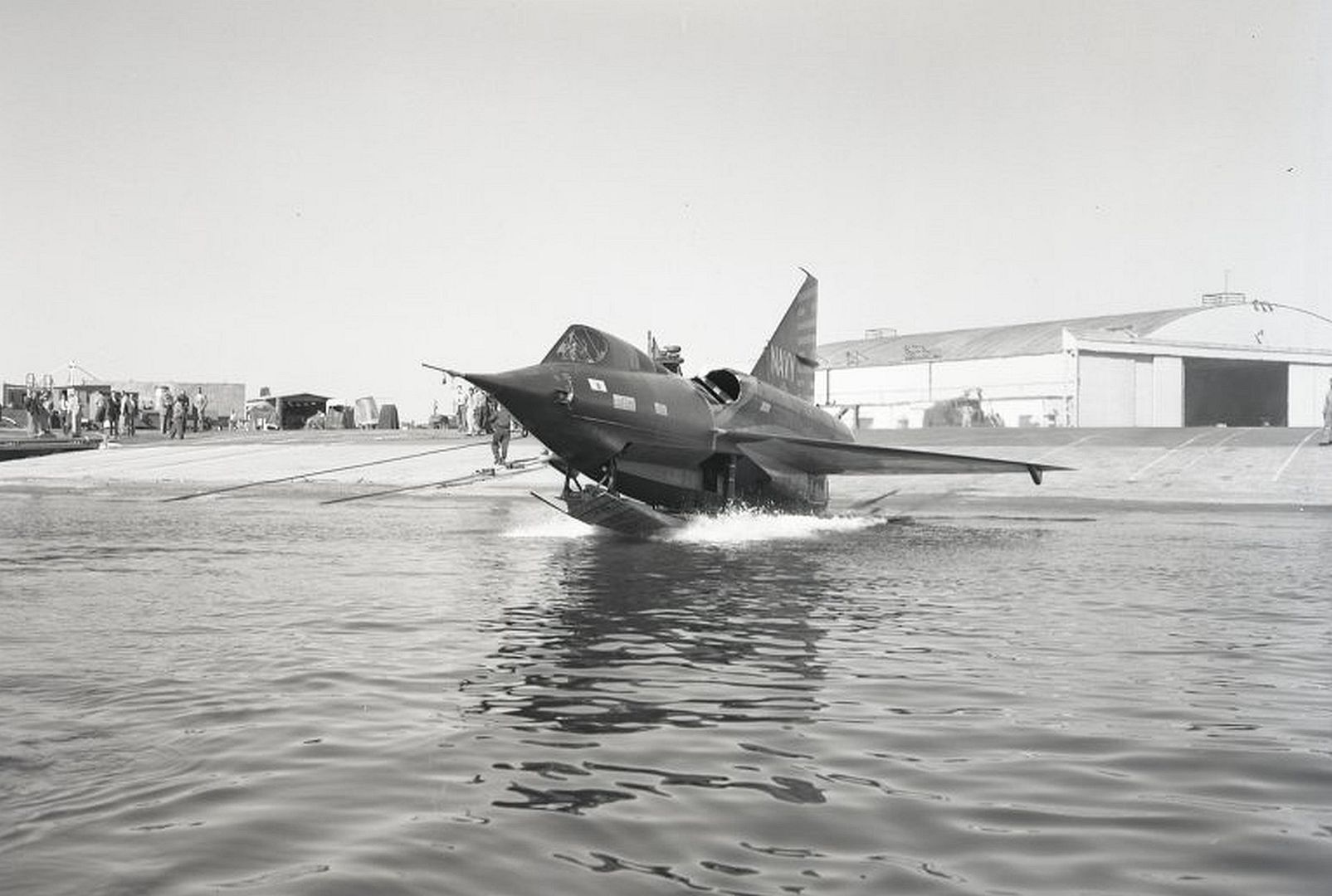

The aircraft took off and landed on a pair of retractable hydro-skis that extended outward on oleo legs from recesses cut into the lower hull, one ski on each side of the hull. During takeoff, the skis were initially fully retracted into their wells. Then as power was applied and the leading edge of the ski broke the water at 9-11 mph, the skis were extended to an intermediate position until 45-55 mph was reached. The skis were then extended to their fully-extended position, and the aircraft accelerated to a takeoff speed of about 145 mph.

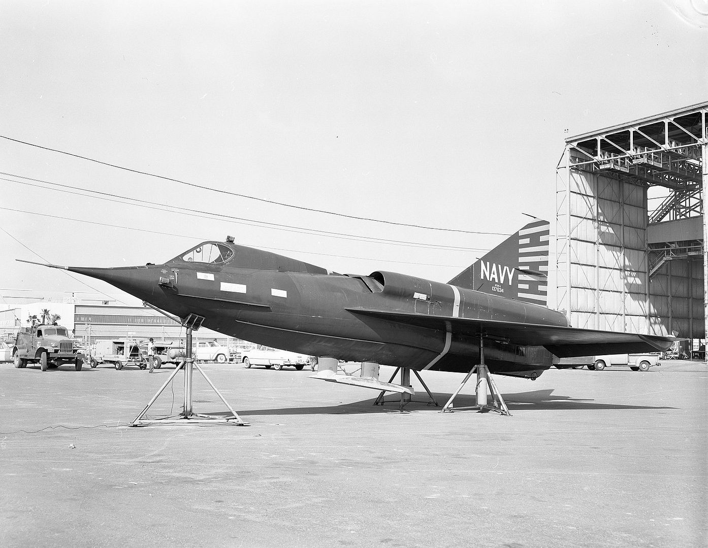

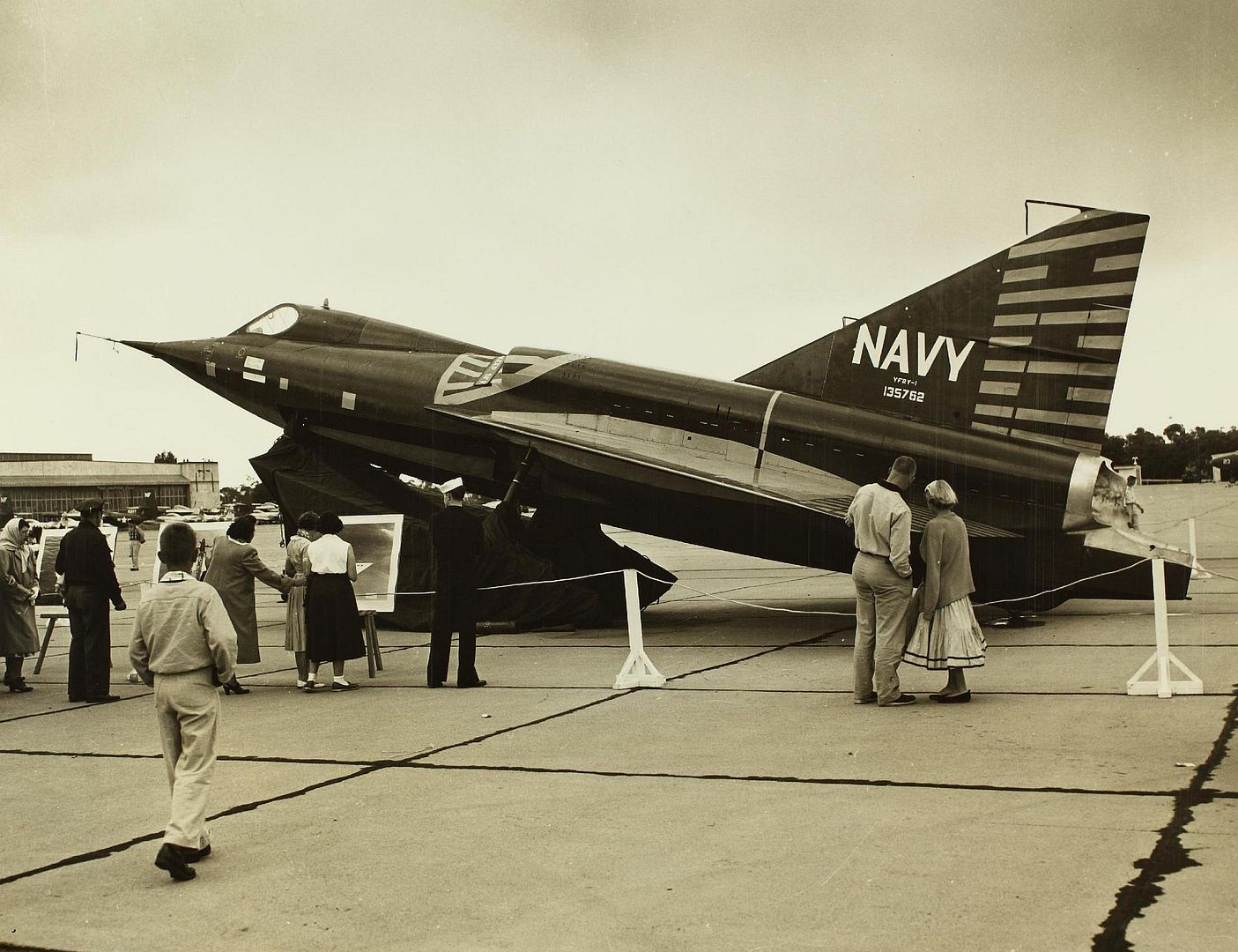

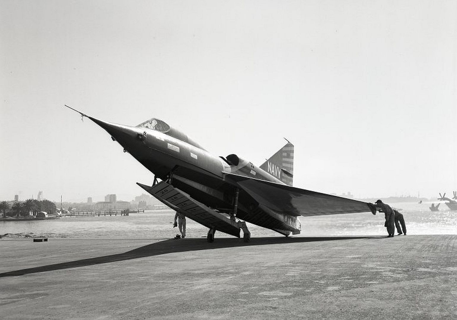

When the aircraft was sitting on dry land out of the water, it tilted backwards on its extended skis, its tail resting on the ground. Each of the twin retractable hydro-skis had a small fixed wheel at its aft end, and there was a small fixed swiveling tailwheel mounted underneath the rear fuselage. This provided for a limited amount of ground maneuverability, which made it possible for the aircraft to enter or leave the water via a long ramp under its own power. However, the aircraft could not take off or land on conventional runways.

Pending the availability of the J46s, the first prototype XF2Y-1 (BuNo 137634) was fitted with two side-by-side non-afterburning Westinghouse J34-WE-32 engines of 3400 lb.s.t. each. In the late autumn of 1952, the completed aircraft was transferred from the experimental shop at Convair's Lindbergh Field facility to the Convair seaplane ramp area on San Diego Bay. On December 14, 1952, E. D. "Sam" Shannon began taxiing trials in San Diego Bay with the XF2Y-1 prototype. On January 14, 1953, he made an inadvertent first hop of 1000 feet during a high-speed taxiing run. The XF2Y-1 prototype made its official maiden flight on April 9, 1953.
The first flight tests revealed (as expected) that the aircraft was severely underpowered for its weight. In addition, the waterskis vibrated continuously during takeoff and landing, so much so that the aircraft was extremely difficult to control. In order to cure the vibration problem, the skis were redesigned and the oleo legs were improved. This seemed to help somewhat. However, the absence of an area-ruled fuselage (plus the lack of adequate engine power) meant that that the XF2Y-1 could not exceed the speed of sound in level flight.

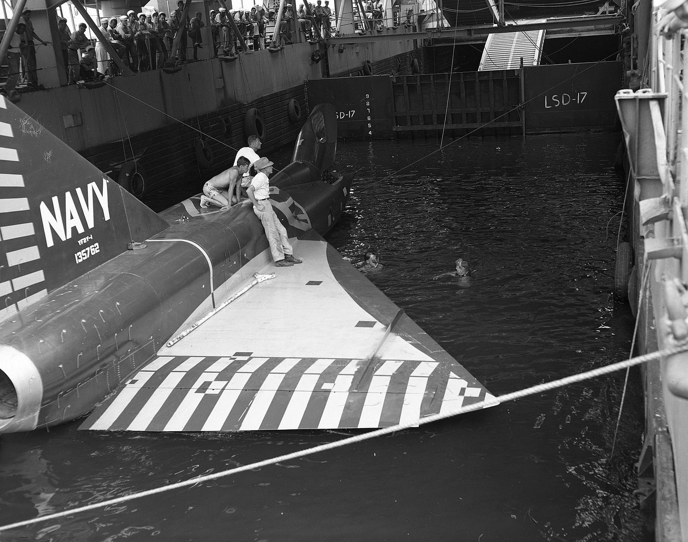

The first YF2Y-1 (BuNo 135762) service test aircraft joined the test program in early 1954. Since the second XF2Y-1 (BuNo 137635) had been cancelled, YF2Y-1 BuNo 135762 was the second SeaDart aircraft actually to be built. It was powered by a pair of afterburning Westinghouse J46 turbojets. In overall appearance, the YF2Y-1 was similar to the XF2Y-1 except for the J46 engines. However, the aft fuselage at the engine exhaust area was significantly different, with the engine nacelles and nozzles extending further aft. The YF2Y-1 differed from the XF2Y-1 in not having wheels on the rear of its twin skis, so auxiliary beaching gear was required during entry to or exit from the water.
Convair test pilot Charles E. Richbourg made the initial flight tests of the number two SeaDart. On August 3, 1954, Richbourg took BuNo 135762 through the sound barrier while in a shallow dive. This made the SeaDart the first (and to date the only) seaplane to go supersonic. Since the SeaDart had been designed before the advent of the area rule, the aircraft experienced high transonic drag and was unable to exceed the speed of sound in level flight. Flight tests indicated some wing spanwise airflow, and a single airflow fence was mounted on each upper wing surface near the tip. No other SeaDart was fitted with wing fences.

In spite of the project cancellation, tests continued with the sole XF2Y-1. During the summer of 1954, the XF2Y-1 was extensively reworked. The aft fuselage was brought up to YF2Y-1 configuration with afterburning Westinghouse J46 turbojets. The aircraft was fitted with a large, single hydro-ski in place of the original pair of skis. The single-ski installation was not fully retractable, since high-speed flight was never planned. The previous twin-ski fuselage wells were not filled in or covered over for the single-ski installation, and during flight, the single ski was held below the fuselage in an external position parallel to the aircraft's longitudinal axis. The rear part of the ski was extended downward for takeoff or landing. The rear part of the single ski had a pair of retractable wheels on either side for use in moving the aircraft into and out of the water, the aircraft resting nose-up on a small tailwheel. Like the dual-ski XF2Y-1, the aircraft could be launched or recovered from the water without the need for auxiliary beaching gear. The XF2Y-1 flew for the first time in this configuration on December 29, 1954, with Convair test pilot B. J. Long at the controls.
The first tests with the single sky encountered the divergent and uncontrollable hydrodynamic longitudinal pitch oscillations. These were corrected by adding a new ski oleo damping device what sensed stroke rate and varied the oleo hydraulic orifices and provided the needed damping qualities. Lateral directional control problems that had been encountered were corrected by doubling the lateral deflection of the elevons relative to the pilot control stick movements. The single ski could even safely handle crosswind takeoffs and landings with a wingtip dragging in the water. The aircraft could even operate in waves of up to 6 to 10 feet in height, far in excess of the requirement. The last single-ski test with the XF2Y-1 took place January 16, 1956, when an open-sea landing and takeoff was carried out. After the completion of the tests, the XF2Y-1 was placed in storage.
