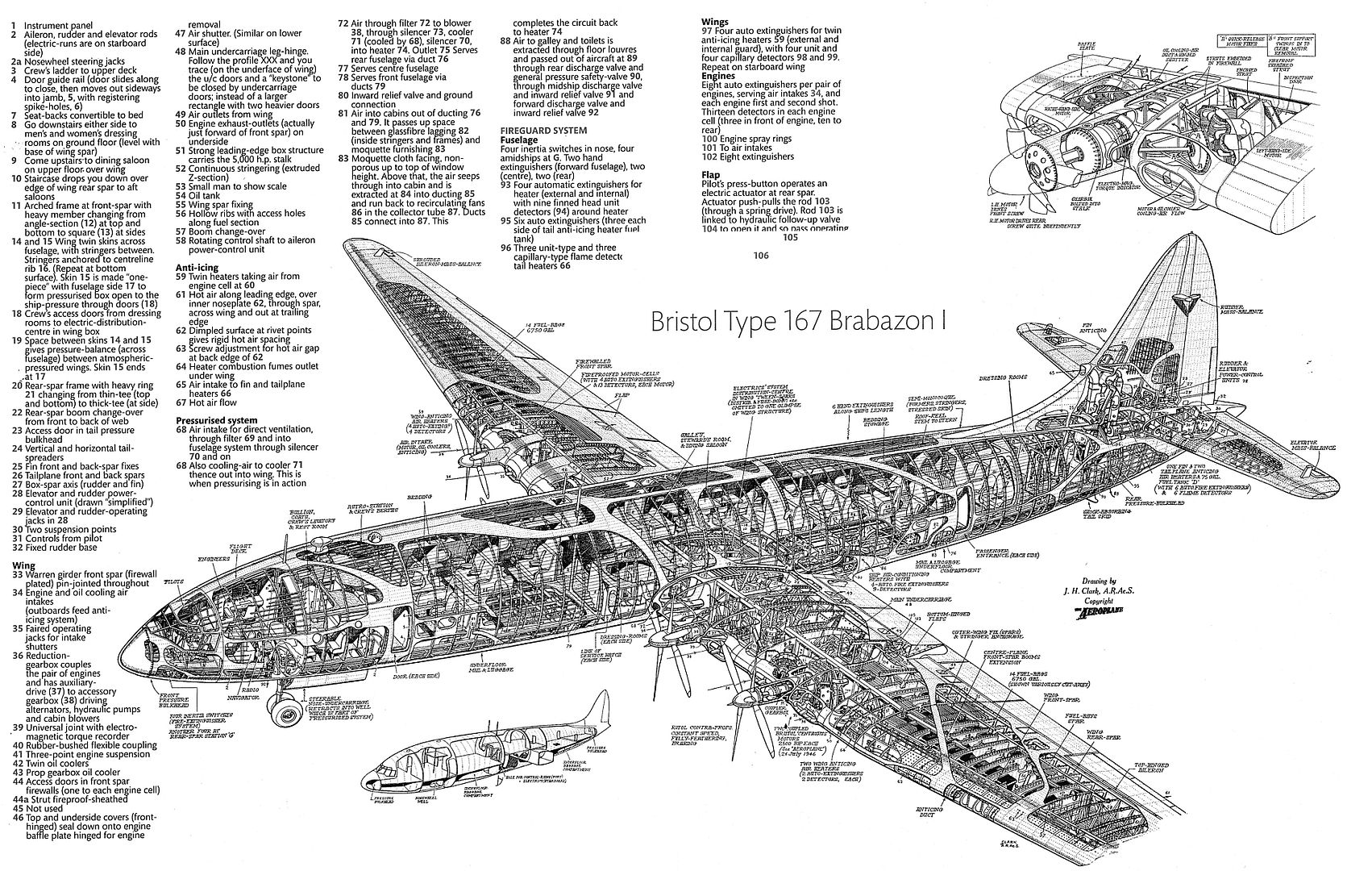

In November 1944, following on from further work on the design, a final concept for the Type 167 was published. As it stood in the final concept, the design featured a large 177 ft (54 m) fuselage which was paired with a sizable wing. This wing, which had a 230 ft (70.1 m) wingspan, possessed an enormous internal volume, which was used to house the fuel for the transatlantic flights envisioned for the type. It was powered by eight Bristol Centaurus 18-cylinder radial engines; these were the most powerful British-built piston engines available at the time, each being capable of generating 2,650 hp. These engines which were installed in a unique arrangement of setting each engine in pairs in the wing; instead of using a common crankshaft, the paired engines each had their driveshafts angled towards an enormous central gearbox. They drove a series of eight paired contra-rotating propellers, which were set on four forward-facing nacelles.

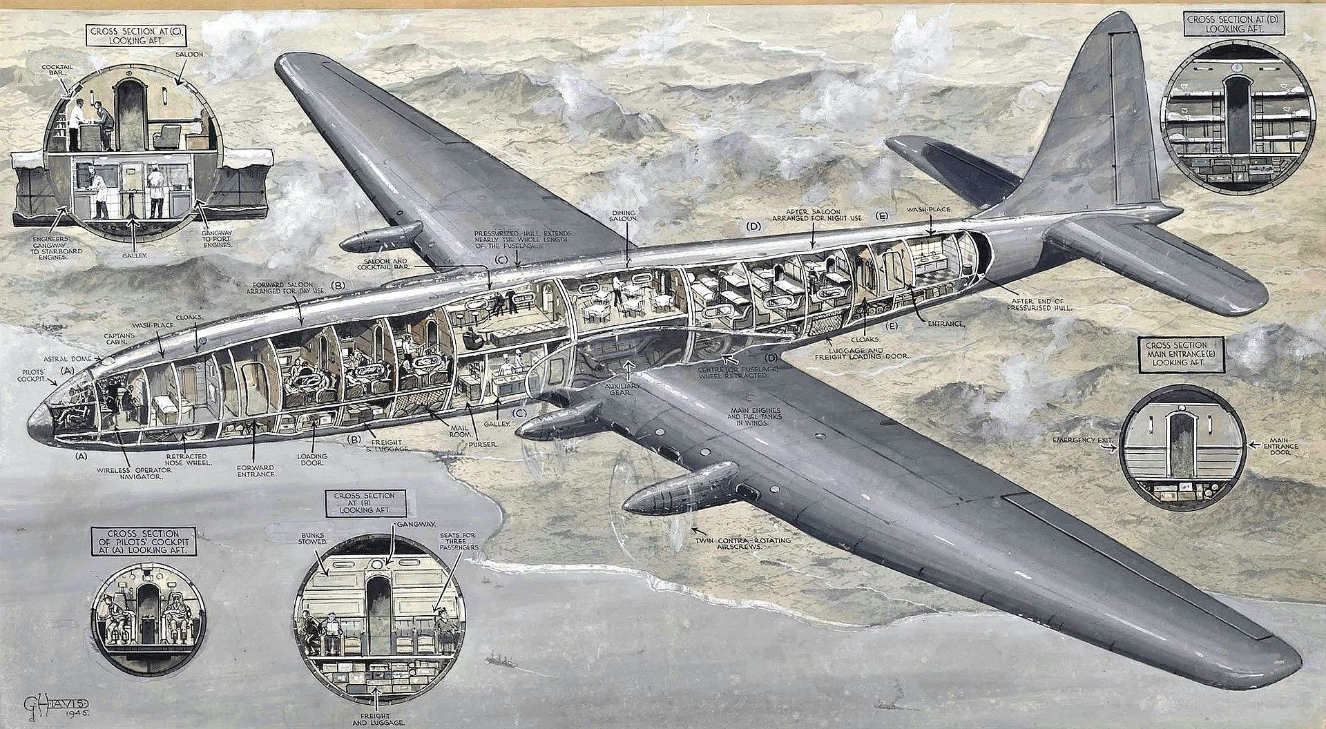

The Brabazon Report had assumed that the wealthy people flying in the aircraft would consider a long trip by air to be uncomfortable, and they had accordingly designed the Type I for luxury, demanding 200 ft3 (6 m3) of space for every passenger, this was expanded to 270 ft3 (8 m3) for luxury class. If outfitted with conventionally spaced seating, the dimensions of the Type 167 could have accommodated up to 300 passengers, instead of the 60 seats opted for. Other high-comfort measures were proposed for installation on operational aircraft, such as an onboard cinema, a cocktail bar, and lounge area. According to Author Stephan Wilkinson, the decision to focus on comfort over other qualities such as speed and payload had been a historic preoccupation of Britain operators to specifically tailor their services towards wealthy travellers, and noted this as having been a key pre-war ethos of British airline Imperial Airways. Meanwhile, some figures within the aircraft industry were forecasting heavy demand from the passengers then relying on ocean liners.
To meet these varied requirements, the Type 167 specified a huge 25 ft (8 m)-diameter fuselage, which is about 5 ft (1.5 m) greater than a 747, with full-length upper and lower decks. This enclosed sleeping berths for 80 passengers, a dining room, 37-seat cinema, promenade and bar; or alternatively an arrangement of day seats for 150 people. At one point, the Committee recommended the adoption of a narrower fuselage that was intended to house a total of 50 passengers; the British Overseas Airways Corporation (BOAC) agreed with this recommendation, and also expressed its preference for a design accommodating only 25 passengers. In August 1943, an agreement reached with the airline led to the selection of an interior layout which contained a forward area housing six compartments, each one for six passengers, along with a seventh compartment for just three passengers; a midsection above the wing – the wing was 6 feet deep at that point – which accommodated 38 seats arranged around tables in groups of four along with a pantry and galley; and a rear area populated by 23 seats within an aft-facing cinema, complete with a cocktail bar and lounge. Similar to the Saunders-Roe Princess, the Brabazon concept was a fusion of prewar and postwar thinking, using highly advanced design and engineering to build an aircraft that was no longer required in the postwar world.

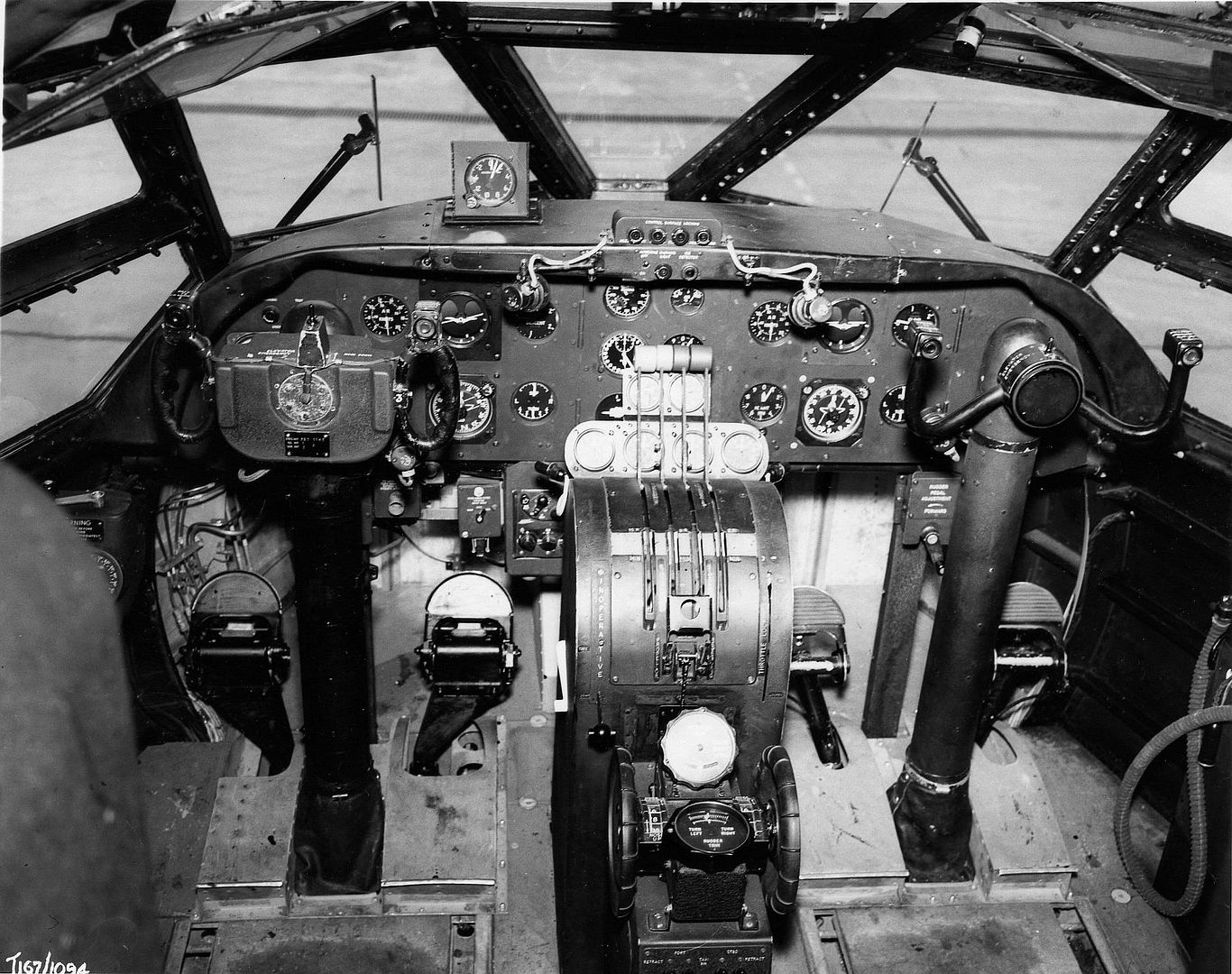

The Brabazon was the first aircraft to be outfitted with 100 per cent powered flying controls; it was also the first to feature electric engine controls, and the first equipped with high-pressure hydraulics. The large span and mounting of the engines close inboard, together with structural weight economies, demanded some new measure to prevent bending of wing surfaces in turbulence. Thus, one of the innovative features of the Brabazon was a purpose-developed gust-alleviation system, which used an assortment of servos that were triggered from a gust-sensing probe installed on the exterior of the aircraft's nose; an improved version of this system, along with fully automated trimming, was to have been deployed on board the Brabazon Mark II. Hydraulic power units were also designed to operate the aircraft's giant control surfaces.

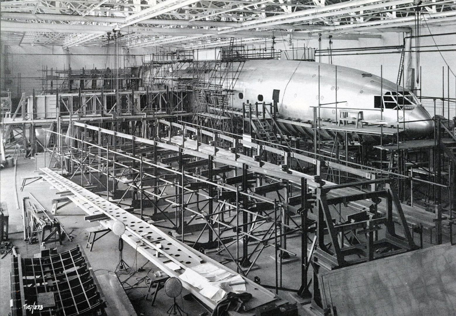

A tremendous effort was put into saving weight across the aircraft. The Type 167 used a number of non-standard gauges of skinning in order to tailor every panel to the strength required, thereby saving several tons of metal. Bristol employed revolutionary new machining and construction methods for drilling, milling, folding, and rolling many of the airframe's components. Rivets were sealed in aircraft dope to greatly reduce the number of rivets required for airframe assembly. Significant emphasis had been placed upon simplifying the construction process and incorporating several manufacturing efficiencies. Some of the design and construction work for the aircraft was shared out to other British companies, such as Folland Aircraft.

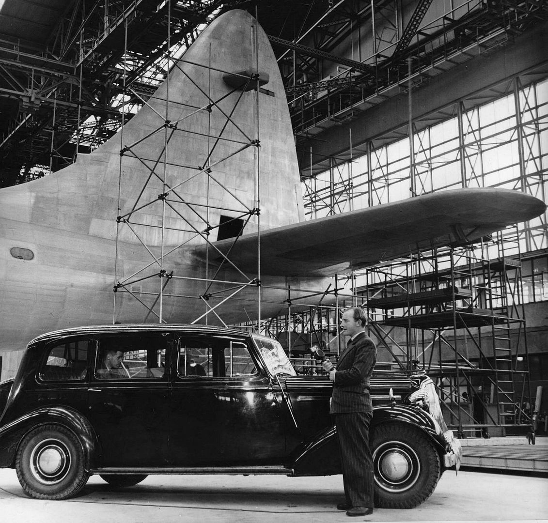

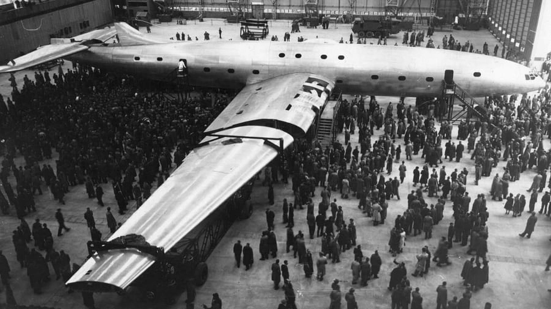

The act of manufacturing the Brabazon alone was found to be a challenge. During the first two years of the development, the question of how and where to manufacture the aircraft was amongst the biggest issues that had preoccupied the design team and delayed progress on the project.Bristol's existing factory at Bristol Filton Airport proved to be too small to handle what was one of the largest aircraft in the world, let alone producing the type in quantity, while the adjacent 2,000 ft (610 m) runway was also too short to launch it. While considerations were made for developing the firm's Banwell facility, it was eventually decided to expand the main Filton site to suit the Brabazon. Work on the project was slowed as a consequence of meeting Bristol's wartime commitments; amongst the early physical steps was the construction of a full-scale wooden mockup in the old No. 2 Flight Shed so that components and fittings could be applied and tested.

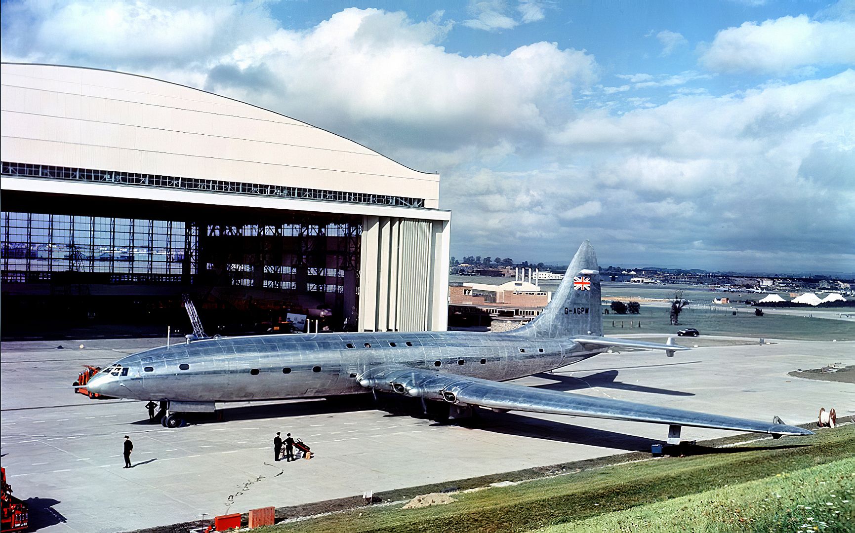

In October 1945, construction of the first prototype's fuselage commenced in an existing hangar while a gigantic hall for performing final assembly of up to eight Brabazons was constructed; at the time of construction, the hall was the largest hangar in the world. the designer of the new assembly hall, T. P. O'Sullivan, was subsequently awarded the Telford Premium for the work. The runway was also lengthened to 8,000 ft (2,440 m), as well as being widened; this extension had necessitated the compulsory relocation of the inhabitants of the village of Charlton to neighbouring Patchway, which was a somewhat controversial measure at the time.

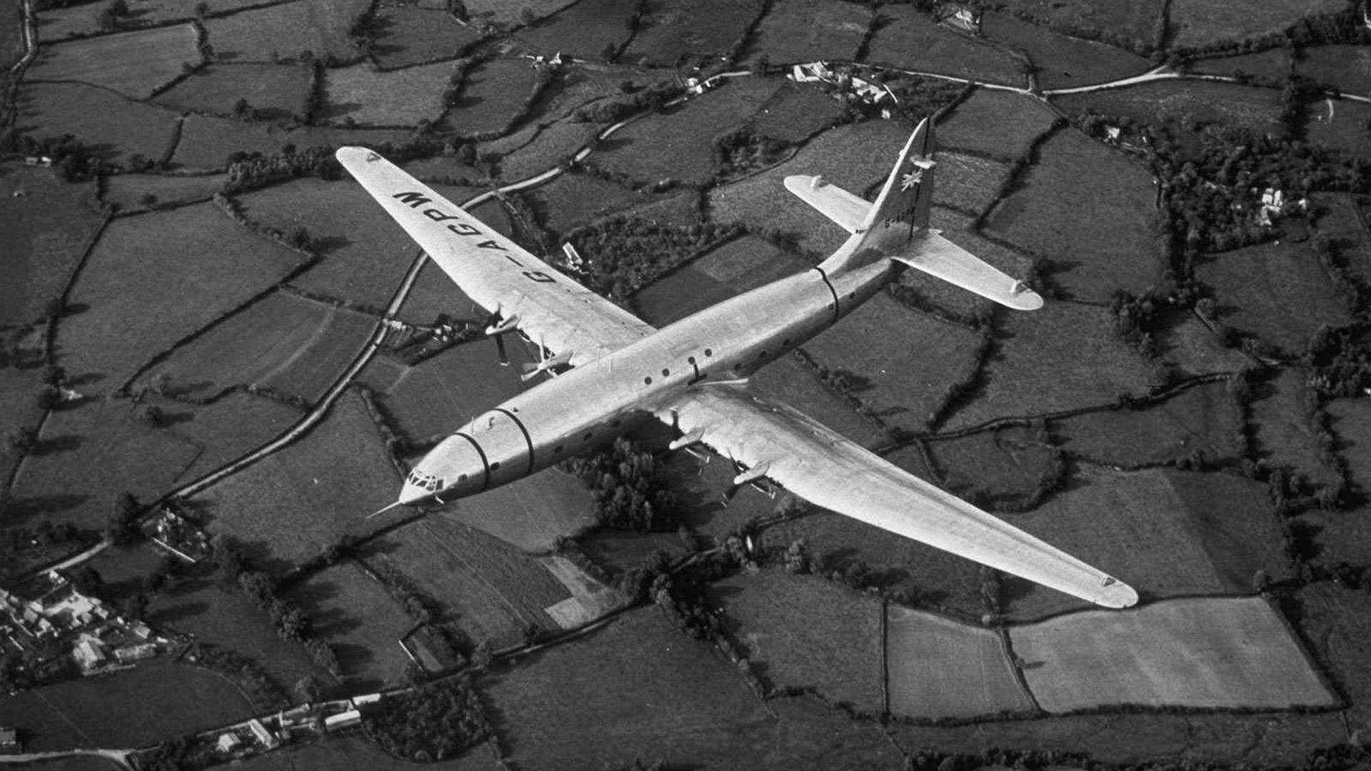

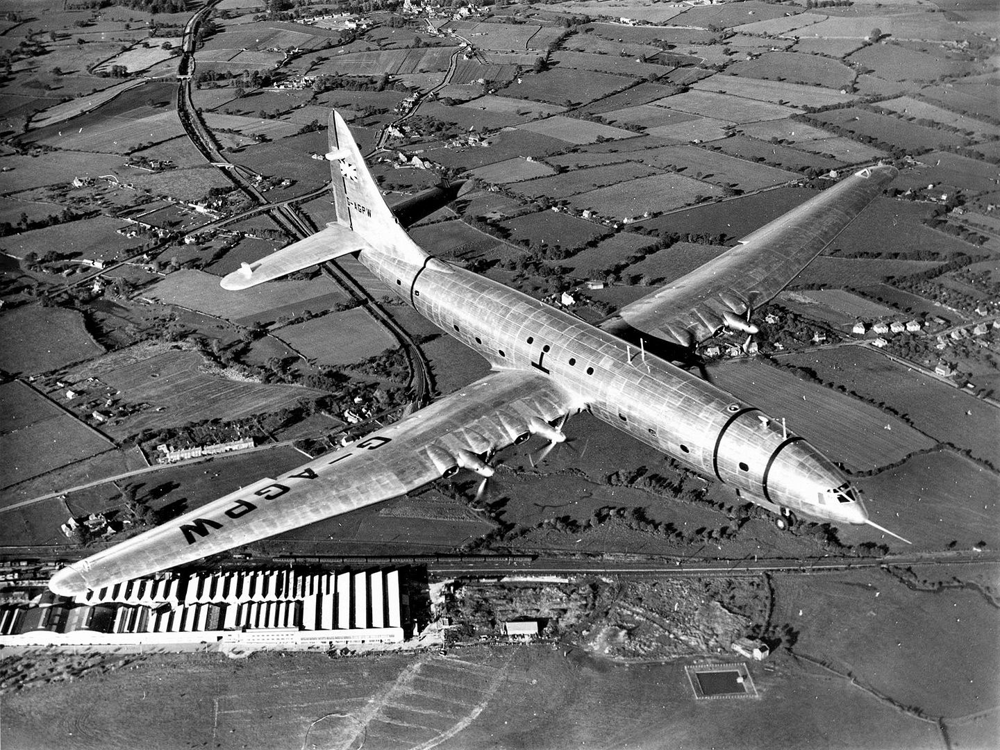

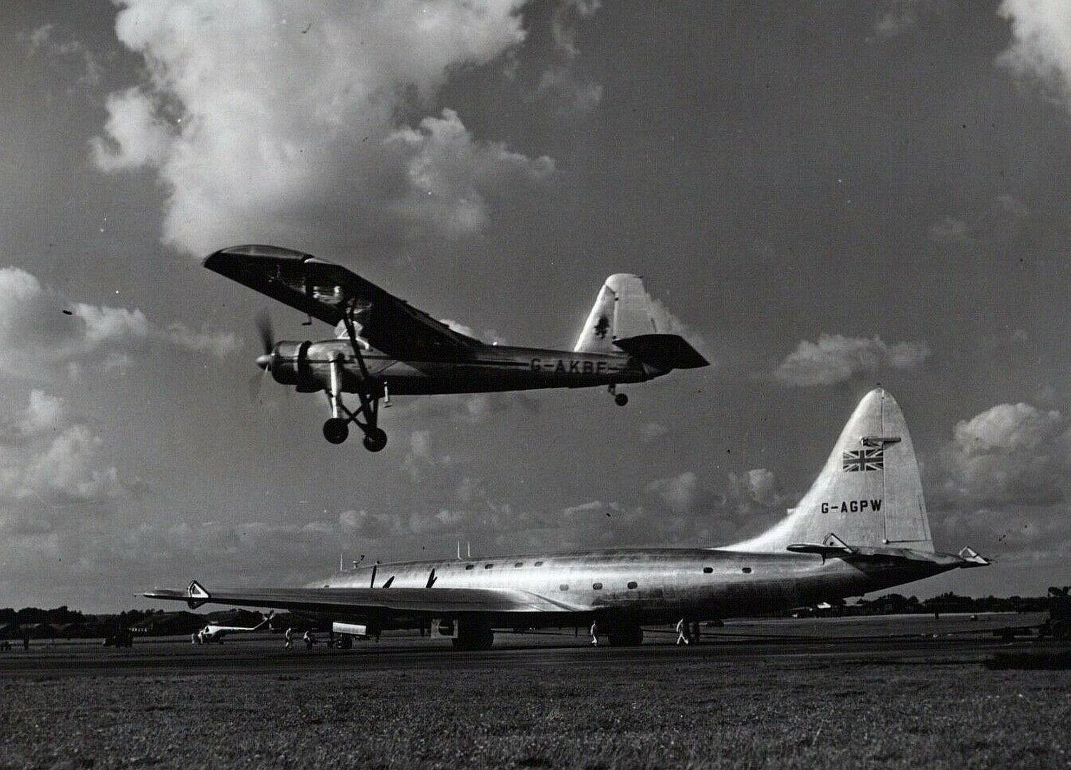

During December 1948, the Mk.I prototype, registration G-AGPW, was rolled out for engine runs. On 3 September 1949, the prototype, piloted by Pegg and co-piloted by Walter Gibb, along with a crew of eight observers and flight engineers, performed a series of trial taxi runs; these revealed no problems save for the nosewheel steering not working correctly, thus this was temporarily disabled. On 4 September 1949, the prototype performed its maiden flight over the Bristol area, flying for a total of 25 minutes, captained by Pegg. Prior to the takeoff, around 10,000 people had gathered at the airfield's perimeter to witness the feat. During this flight, it ascended to about 3,000 ft (910 m) at 160 mph (257 km/h) and landed at 115 mph (185 km/h), throttling back at 50 ft (15 m). The British press mainly reported favourably of the occasion, one newspaper praising the aircraft as being "the queen of the skies, the largest land-plane ever built".

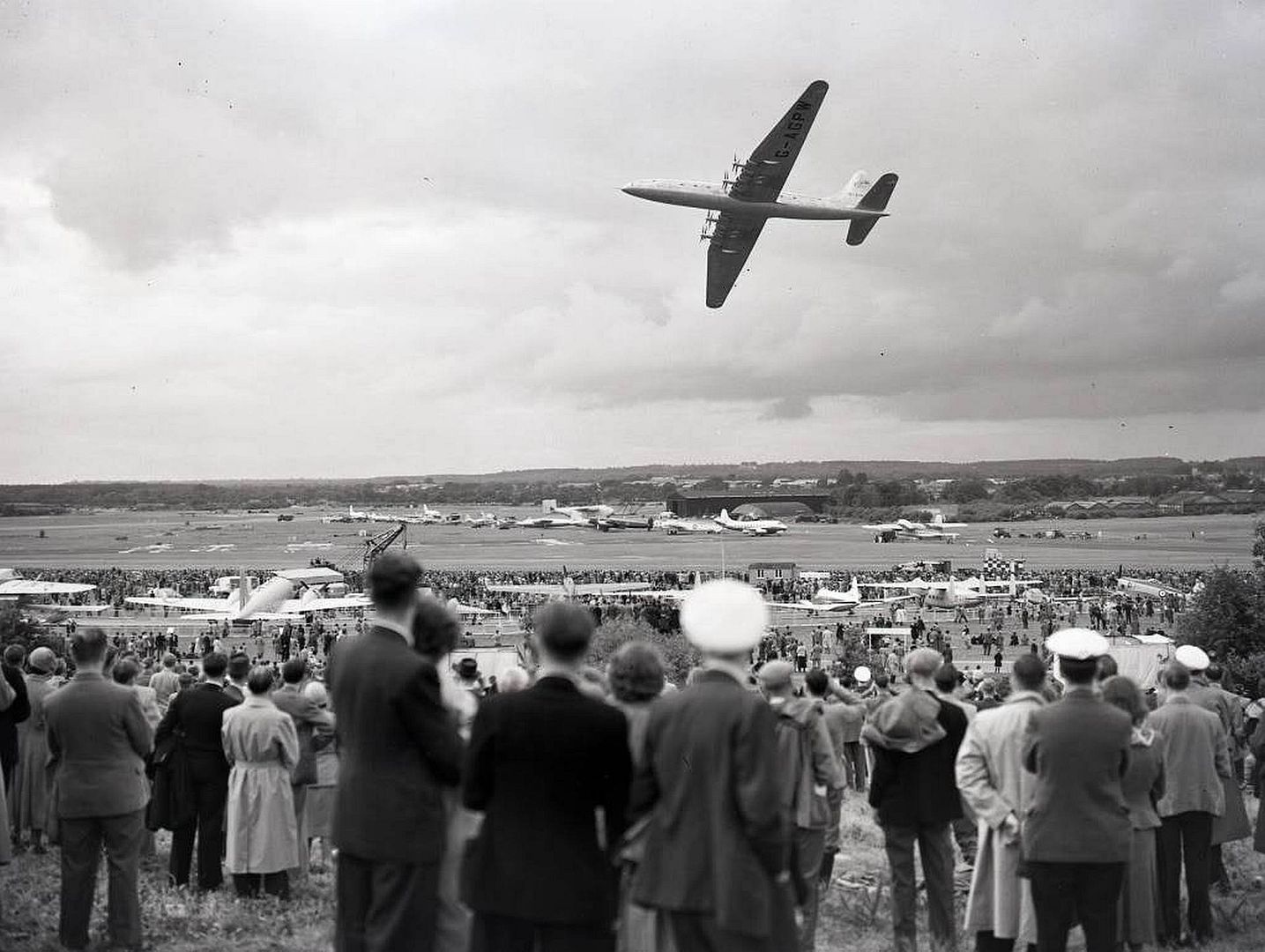

Four days later, the prototype was presented at Society of British Aircraft Constructors' Airshow at Farnborough; according to author Philip Kaplan, the timing of the first flight had been set as such to enable such a high-profile early appearance to be performed. The Brabazon's appearance at Farnborough would lead to the adoption of a formal and deliberate company policy as much of the aircraft's test programme in the vicinity of various British cities in order to spread public awareness. Accordingly, the Brabazon was demonstrated at the 1950 Farnborough Airshow, at which it performed a takeoff, clean configuration flypast and a landing. In June 1950, the Brabazon made a visit to London's Heathrow Airport, during which it made a number of successful takeoffs and landings; it was also demonstrated at the 1951 Paris Air Show. Gibb, who flew the aircraft as pilot-in-command on multiple flights, summarised his flying experiences with the type: "It was very comfortable. It flew very well. It was big. You didn't whip it around like a Tiger Moth or Spitfire, but as long as you treated it like a double-decker bus or a large aeroplane, you had no trouble at all".

Below construction

Specifications (Mark I)
Crew: 6–12
Capacity: 100 passengers
Length: 177 ft (54 m)
Wingspan: 230 ft (70 m)
Height: 50 ft (15 m)
Wing area: 5,317 sq ft (494.0 m2)
Airfoil: root:T.P.4; tip: T.P.5[30]
Empty weight: 145,100 lb (65,816 kg)
Max takeoff weight: 290,000 lb (131,542 kg)
Fuel capacity: 13,650 imp gal (16,393 US gal; 62,054 l)

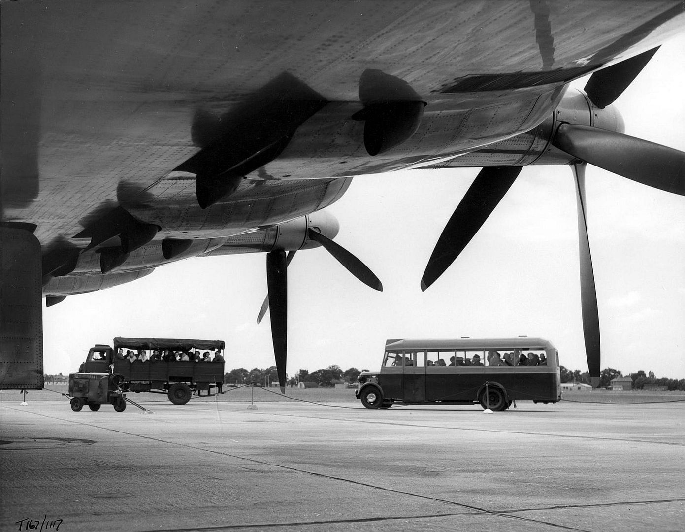

Powerplant: 8 × Bristol Centaurus 18-cylinder air-cooled radial sleeve-valve piston engines, 2,650 hp (1,980 kW) each paired, driving contra-props through combining gearboxes.
Propellers: 3-bladed Rotol, 16 ft (4.9 m) diameter fully-feathering contra-rotating propellers
Maximum speed: 300 mph (480 km/h, 260 kn) at 25,000 ft (7,620 m)
Cruise speed: 250 mph (400 km/h, 220 kn) at 25,000 ft (7,620 m)
Range: 5,500 mi (8,900 km, 4,800 nmi)
Service ceiling: 25,000 ft (7,600 m)
Rate of climb: 750 ft/min (3.8 m/s)
Wing loading: 54 lb/sq ft (260 kg/m2)
Power/mass: 0.073 hp/lb (0.120 kW/kg)
