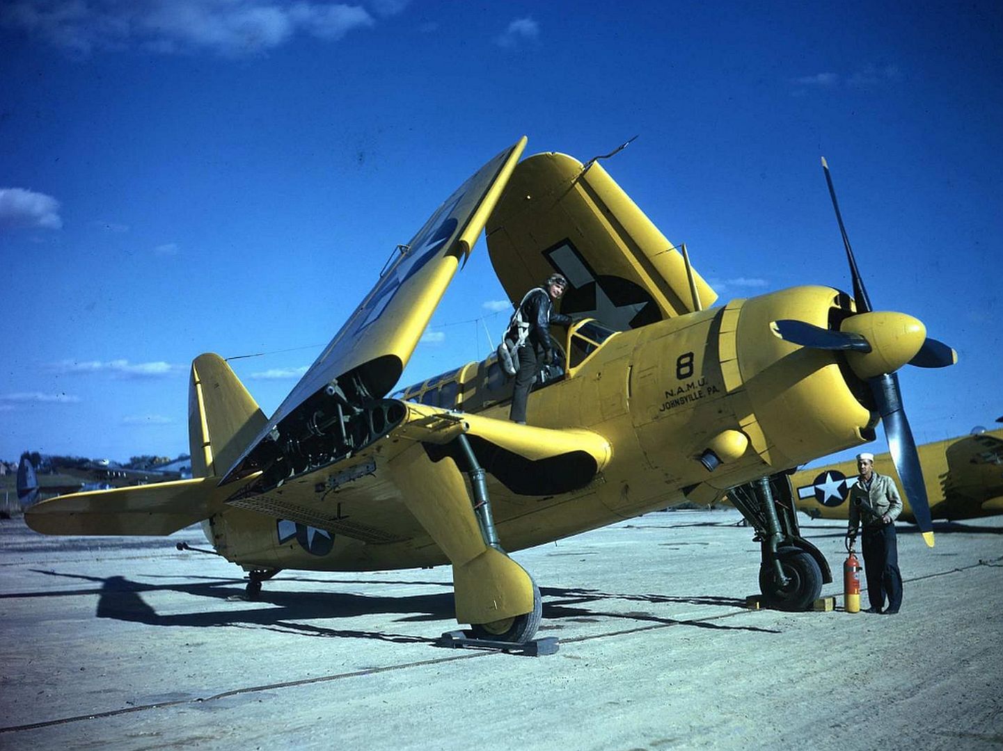

Below misc.
As usual right click and save as for details.
