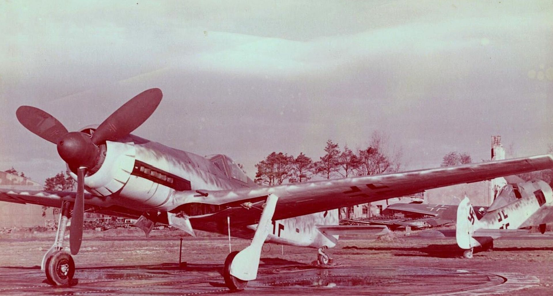

Below The third Ta 152A prototype, the Fw 190V21, W.Nr. 0043, TI+IH, first flew on 13 March 1944 with Focke¬Wulf experimental test pilot Bernhard Marschel at the controls.
Below TA-152-W-Nr006
Below Focke-Wulf Ta.152V-7 (Ta.152C-0-R11) CI+XM serial number of the machine (W.Nr.110007) at the airfield in the city of Langenhagen
Below TA-152 GH-KT Wr Nr 0055
Below Focke-Wulf Ta 152H-1 (Wk. Nr. 150168)
Below Focke-Wulf Ta.152H-0 (Werk Nr 150010) The NASM plane, the last Ta.152 in existence, is a pre-production Ta.152H-0 model. For many years it was described (wrongly) as Werk Nr 150003. It is now thought to be Werk Nr.150010. This places the airframe in the range of pre-production H-0 models, a variant marking the transition from the Ta.152 prototypes to full production Ta.152H-1 airplanes. It was probably built at Focke-Wulf's production facility at Cottbus, Germany, in December 1944, and delivered by Erprobungskommando Ta.152 at Rechlin, Germany, for service testing with the Geschwaderkennung CW+CJ. Transferred to the operational Luftwaffe unit JG 301 where it became 'Yellow 4' with II/JG 301 and the Yellow/Red RGV bands were painted on its aft fuselage. It ended up with the staff flight (Geschwader Stab) of JG 301 where it was coded 'Green 4', and the green bar was painted over the RGV bands. It was flown operationally by Ofw Walter Loos in 1945. As the Soviets rolled over eastern Germany, many Luftwaffe pilots took off and steered their mounts west; they preferred to be captured by the Western forces. Surrendered to British forces at Tirstrup, Denmark. Flown by the RAF to Aalborg, Denmark, for servicing. Handed over to Col Watson. Flown to Melun/Villaroche (A-55), France. Later flown to Querqueville (A-23), Cherbourg, France. Operation Seahorse. HMS Reaper loading number 32. Shipped to the USA on the Royal Navy escort carrier HMS Reaper 19Jul45 arriving at the Military Ocean Terminal, Bayonne, New Jersey 31Jul45. Barged to Atlantic Overseas Air Materiel Center, Newark Field, New Jersey. Foreign Equipment Branch, Technical Data Laboratory, Air Technical Service Command, Wright Field, Dayton, Ohio 1Aug45. Assigned FE-112.
Below Focke-Wulf Ta 152H-0 with external 300 liter tank
Below Focke-Wulf Ta 152B
Below Focke-Wulf TA-152 V5
