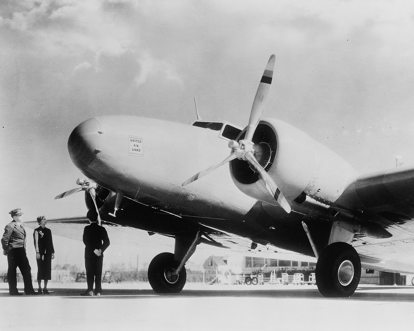

Boeing considered safety features carefully, building in structural strength as well as incorporating design elements that enhanced passenger comfort and well-being, such as the thermostatically-controlled, air conditioned and soundproof cabin. The crew included a pilot and copilot as well as a flight attendant then known as a stewardess, who could tend to passenger needs. The main landing gear did not fully retract; a portion of the wheels extended below the nacelles, typical of designs of the time, as a means of reducing structural damage in a wheels-up landing. The tailwheel was not retractable. While the Model 247 and 247A had speed-ring engine cowlings and fixed-pitch propellers, the Model 247D incorporated NACA cowlings and variable-pitch propellers.

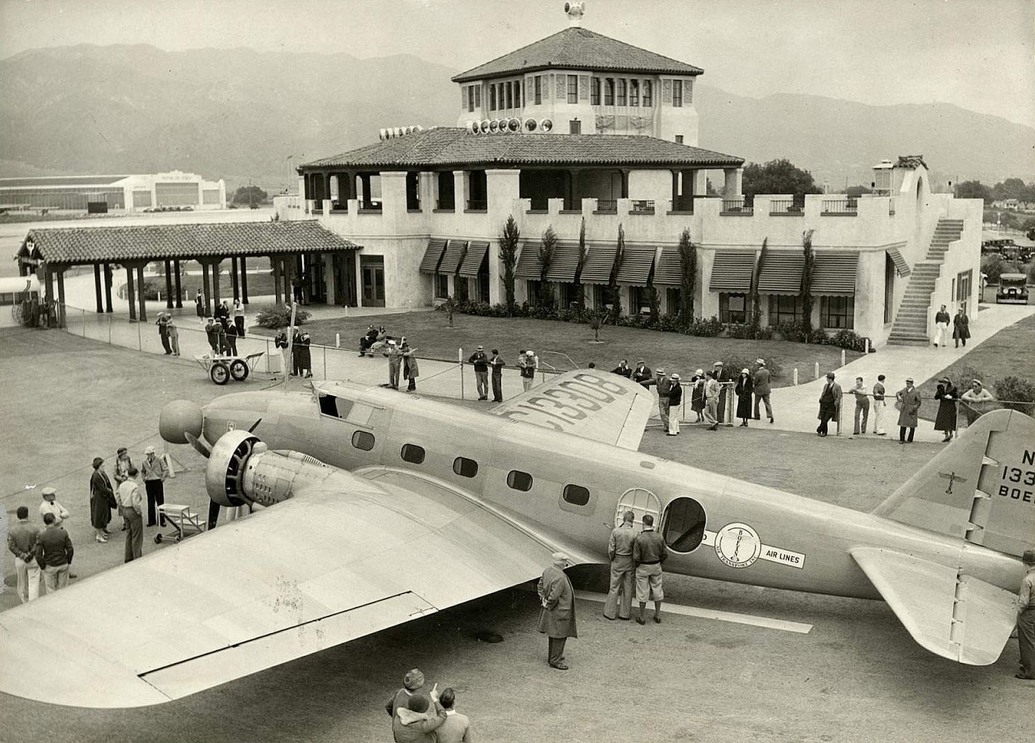

Being the winner of the 1934 U.S. Collier Trophy for excellence in aviation design, the first 247 production orders were earmarked for William Boeing's airline Boeing Air Transport. The 247 was capable of crossing the United States from east to west eight hours faster than its predecessors, such as the Ford Trimotor and Curtiss Condor. Entering service on May 22, 1933, a Boeing Air Transport 247 set a cross-country record pace of 19 1⁄2 hours on its San Francisco to New York inaugural flight. For the first time airline passengers could fly across the country without changing planes or stopping overnight.

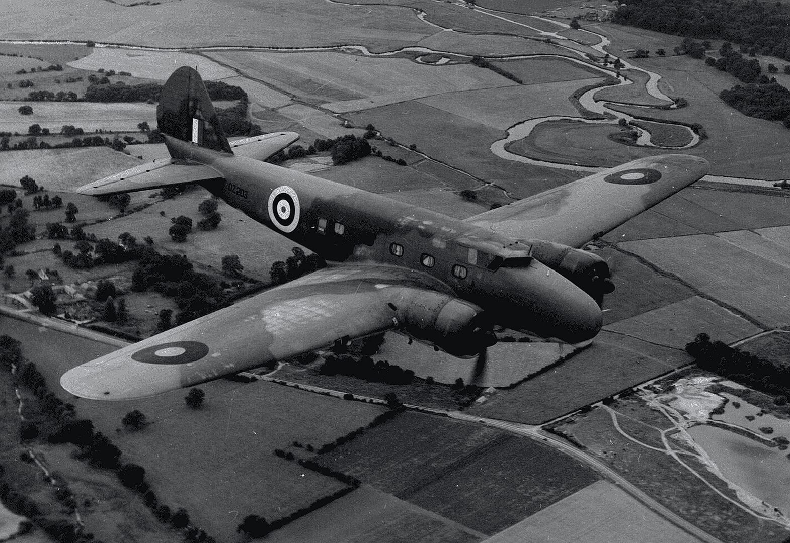

The 247 remained in airline service until World War II, when several were converted into C-73 transports and trainers. The Royal Canadian Air Force's 121 Squadron operated seven 247Ds as medium transports during the early part of the war. One of these aircraft was donated to the Royal Air Force (RAF) for radar testing, where it was renumbered DZ203. DZ203 was passed among several units in the RAF before being used to make the world's first fully automatic blind landing on 16 January 1945.

A number of specially modified variants included a Boeing 247Y appropriated from United for Air Corps use as a test aircraft fitted with two machine guns in the nose. The same installation later was fitted to a 247Y owned by Generalissimo Chiang Kai-shek. This aircraft also featured a Colt .50 in (12.7 mm) machine gun in a flexible mount.A 247D purchased by the British Royal Air Force became a testbed for new equipment and received a nonstandard nose, new powerplants and fixed landing gear.
